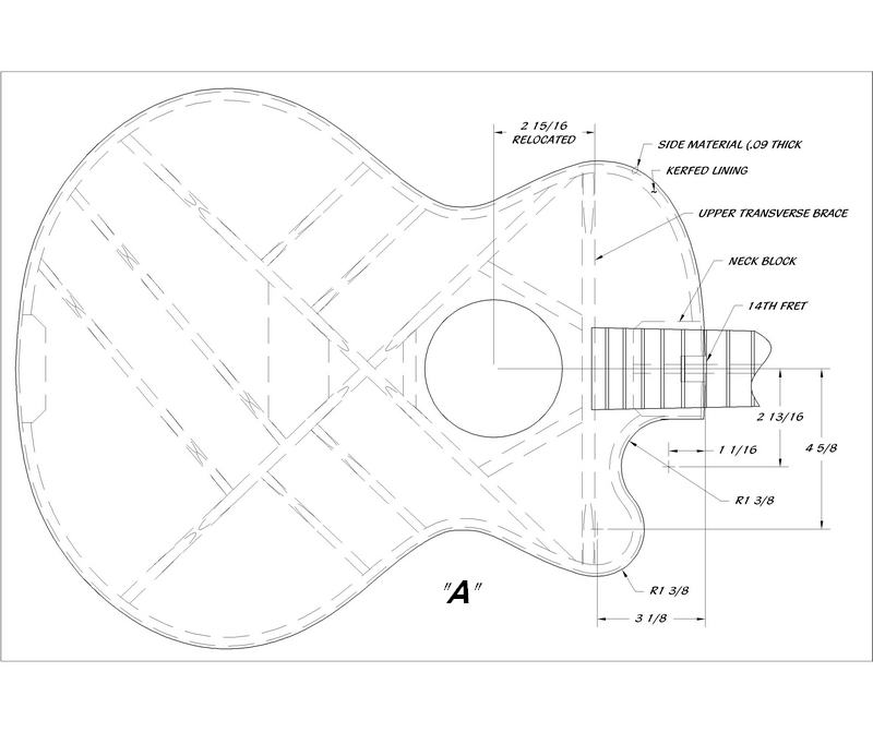

Here are three cutaway details for my new MJ. Which cutaway do you find visually pleasing.

None of the above - I'm a florentine kind of guy (and like Ervin Somogyi's the best). But I voted for A

Definetely A.
I too prefer the floretine look, and I think that design A looks more balanced overall.
B makes the guitar look too "skinny" and C looks like an electric hybrid, akin to something Fender would churn out.
Just my two pence.

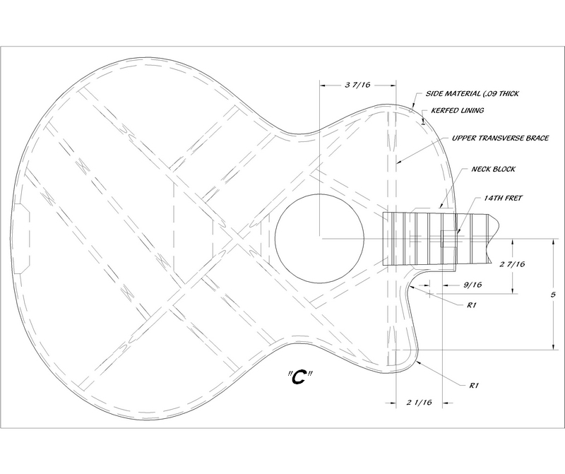

I agree with Jim but I voted for C

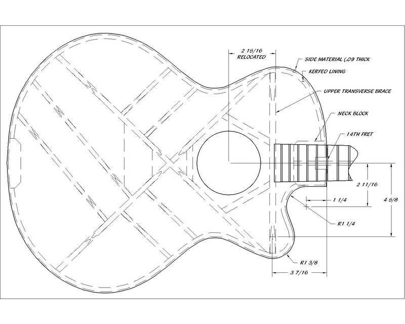

Sorry I did not think of how the poll would take votes when I added the 4 question so just post if you would like to see a cutaway detail added to the MJ plans that will be available in the library of plans.

None of the choices really 'click' for me- 'A' is the best-looking of them , though.
I think that perhaps a 'smooth,flowing' curve, rather than just two circles, would look better. (Flexible ruler or batten vs computer?)
You might also consider narrowing the heel block on the treble side and getting the cutaway a bit closer to the heel- that could soften the curves a bit (and make playing a bit easier as well).
Just my 2cents worth- I've looked at a bunch of cutaways, but haven't had the gumption to make one yet.

I like "A" and yes, I would realy like to see it on the MJ plans, it look great Michael.
A Florentine always look nice also but given the way I play, that pointy bit could be a little risky, you could have somebodies eye out with one of them things.

OK, I'm going to disagree with the florentine lovers. I think "A", or something very similar looks much more natural, and organic (to use a friend's term), on an acoustic guitar than a florentine does. There's no misunderstanding how complex and artistic a florentine is, but I think a venetian is a prettier "flow" for an acoustic guitar.
I vote A, and yes to having it on the plans.
PostPosted: Fri Jul 13, 2007 4:13 am
Hmmmm. IMHO I like A. B seems too closed in - like a telecaster and C is interesting, but I prefer the curved theme/shape to continue all the way around the body, so the straight section is a little too untraditional for my taste.

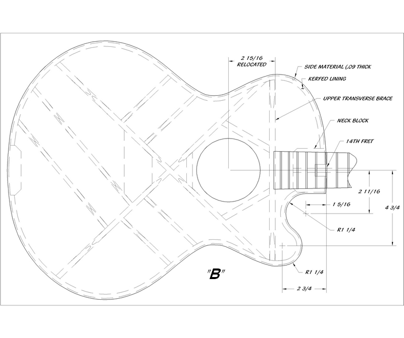

Guess I'll be the loner here. A seems very geometrical to me, not much life in it. B has more grace and movement to my feeble eyes. Also there's something in B that brings out the curve between the treble waist and the upper bout.
PostPosted: Fri Jul 13, 2007 4:33 am
"B"

Actually, I like the side to come in flush with the heel (and use a wide, shallow heel) on cutaways too, so that would change all the geometries above too. (What a grump today! )

I voted A but actually prefer a combination of A and C. That's the way I do my cutaways.
Also, as JohnA said, why does the neckblock not meet the fingerboard on the trebel side? What's the point of having a cutaway if you are going to be banging your hand on the sharp neckblock?

Also, I just noticed that it's braced for a lefty. Is that intentional?

Insert edit button here:
Never mind, I was double mirroring the image in my mind.

C gives a little more hand room, my cutaway is even more open than that. Playing in the cutaway area is hard enough without being cramped so I like open cutaways. On my next cutaway guitar I am going to bevel the cutaway similar to an arm rest to allow just that much easier access playing in that area. My vote is C.
PostPosted: Fri Jul 13, 2007 4:49 am
I'd buy C. The first two seem to eat away too much of the upper bout to me - very "Washburny". Whereas C reminds me of an older Lowden...

[QUOTE=JohnAbercrombie] Michael-
By the way I can draw splined arcs as well true radii that is not an issue. I do tend to want to work cutaways with tangent radii for the ease of making tooling. It is funny you mention bringing the retuning side tangent to the heel. I do that as an option It is more work to adapt the neck block and the side to fit the curvature of the neck heel. So I offer that as a paid for upgrade option on my guitars. Yes I am a capitalist Besides I have an alignment fixture that I use to locate the neck block that indexes the face and 2 45deg chamfers during rim assembly glue up. when I contour the neck block so that the return on the cutaway matches the profile of the necks heel I have to hand fit and clamp the neck block. When I don't I just place the neck block in the assembly bolt down the neck block locating fixture and I don't have to worry about the neck moving on me during glue up.
